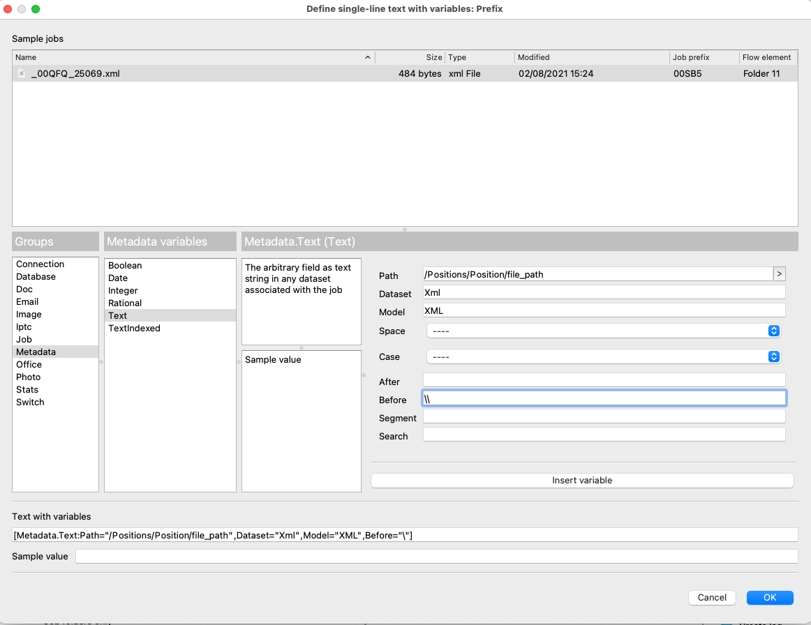

I have a question because I can’t find any information about my problem.
I need to separare part od path included in the XML file and metadata, witch is like for example: 0450-06-2021\karton.pdf. I need only part before \ character 0450-06-2021. Unfortunately when I use funcion Before \, this character is not recognized.
Do You have some idea how I can get only part before backslash?
My XML file is like:
<?xml version="1.0" encoding="UTF-8"?>
<Positions>
<Position>
<position_id>124519</position_id>
<order_id>25069</order_id>
<client_name/>
<width unit="cm">100.00</width>
<height unit="cm">100.00</height>
<surface_name>BACKLIT FLASH; 1800X2400;</surface_name>
<color_name>brak</color_name>
<printer_machine_name>FABRI</printer_machine_name>
<file_path root_path="\192.168.1.193\DTP2">0450-06-2021\karton.pdf</file_path>
</Position>
</Positions>
Zrzut ekranu 2021-08-2 o 16.17.25.png (93.11 KiB) Viewed 12419 times

Have you tried to escape it, \\
Jan Suhr

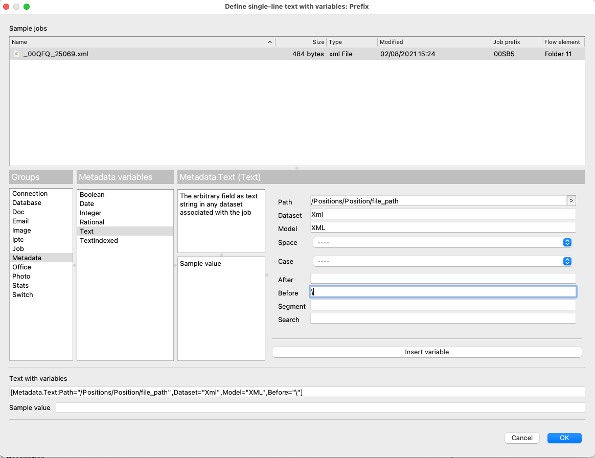

Hi Jan
Unfortunately not working too. I try to use many combination.
Zrzut ekranu 2021-08-2 o 16.31.29.png (93.54 KiB) Viewed 12416 times

Then try \/
Switch can for paths "normalize" slashes to be working on both platforms.

Any combination not working.
\/ no
\\ no
// no
"\\" no
ect ect
