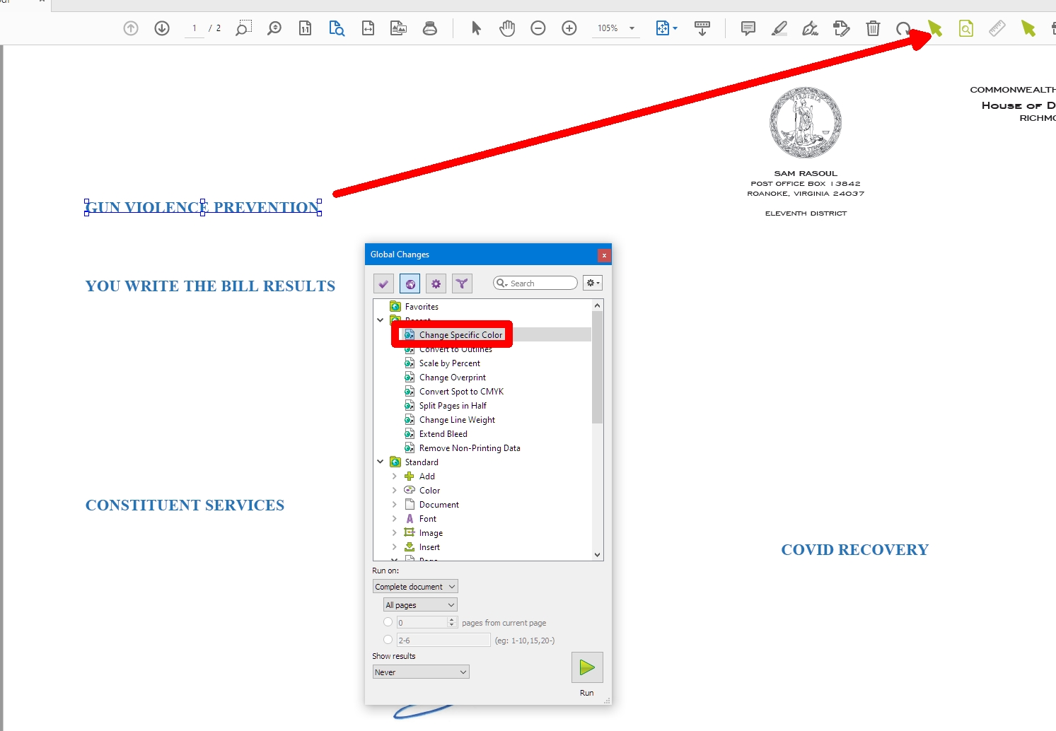

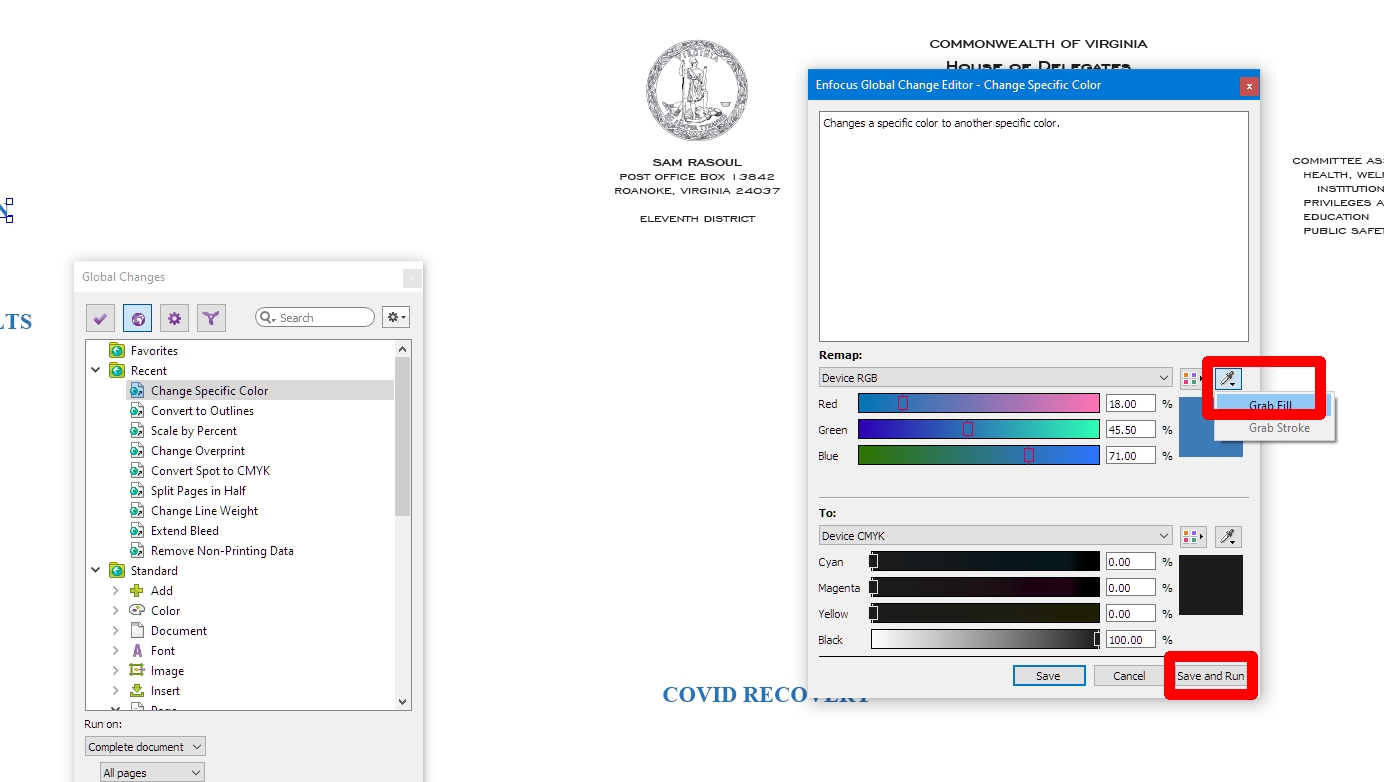

This is one of solution
is only for text
change color 1.jpg (219.72 KiB) Viewed 14051 times
change color 2.jpg (197.61 KiB) Viewed 14051 times

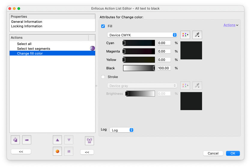

The action "If it looks black and convert to Black" will not work on this document since the blue text doesn't look black ;)
If you just want to convert all text to black a simple action like this will do that:
Skærmbillede 2023-02-16 kl. 14.14.24.png (189.2 KiB) Viewed 13832 times
