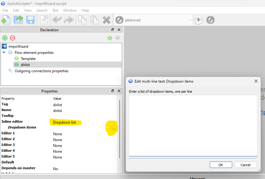

I´m using a node script that reads a directoty content and stores the values in a variable.
I want to make this result apear is a dropdown menu in the switch script so I can select one of the values.
I see that have this option on Switch Scripter but I have to enter manually the values.
Is it possible to populate this dropdown menu with the results from the variable ?

You have the property "Select from library". Then you get a list of values that you can populate from different sources.
You get the values from this Entry point in the script
getLibraryForProperty(s: Switch, flowElement: FlowElement, tag: string): Promise<string[]>

I'm trying to make getLibraryForProperty work,
but I really couldn't understand how to do it.
Below is the example I intend to use.
I have a directory that I need to be the "array" to populate the Library.
Can you give me a tip to solve this?
Thank you very much in advance!
