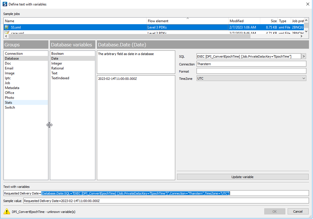

Hello all, I'm trying to convert an Epoch time stamp to a standard date time and add that as a Private Data Key to the job. I am using a database call to send the Epoch value and convert it using a stored procedure in SQL Server. I get the correct date returned, but I am getting an 'unknown variable' error. I've tried changing the Database Variables from Date to Text but that doesn't see to have any affect. Any help would be appreciated!
Here's my statement in Switch:
[Database.Date:SQL="EXEC [DPI_ConvertEpochTime] [Job.PrivateData:Key="EpochTime"]",Connection="Tharstern",TimeZone="UTC"]

Screen Shot
Screen Shot
Switch Error.png (33.61 KiB) Viewed 7161 times

It sounds like the variable error will be coming from the square brackets around your stored procedure name
Try changing the database variable to:
[Database.Date:SQL="EXEC DPI_ConvertEpochTime [Job.PrivateData:Key="EpochTime"]",Connection="Tharstern",TimeZone="UTC"]

mkayyyy wrote: Mon Feb 13, 2023 6:32 pm It sounds like the variable error will be coming from the square brackets around your stored procedure name
Thanks mkayyyy, that was it!
