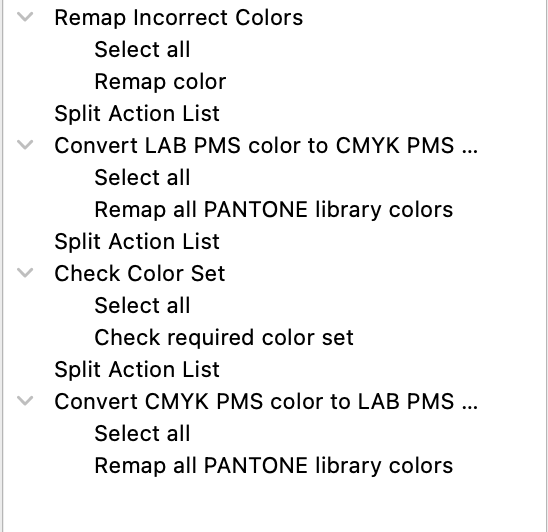

I have built a custom check that check for a certain set of colors. Before the 2023 update it never flagged white (0/0/0/0) but now all of sudden it is flagging every object that is CMYK white.
I have added it the color set list but is still flagging the color.
Any thoughts?

Can you send me your action list and sample file?

So, as it appears, we need to investigate further on the "require color set" action and in this specific case of tagged white. In the meantime, you can use the foolowing workaround to look for "white" objects and discard them from selection (as for the Pantone Colors).
https://fromsmash.com/p~By73n5xH-et
Let me know if that helps

This was logged in our system and need to be further evaluated. In the meantime, did you try the workaround I supplied?
