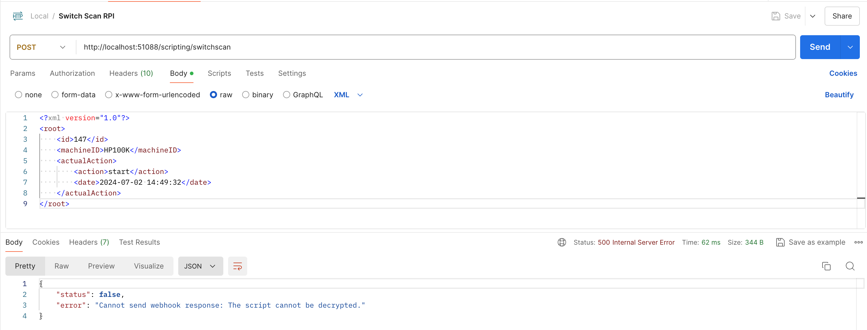

I I tested again with the webhook 8.2 element, and I still get the same error. I attach the Postman result.
I'm running MacOS SOnoma 15.4 and my Postman version is 11.3.1.
Screenshot 2024-07-29 at 16.52.50.png (236.85 KiB) Viewed 13406 times
If I had exactly the same thing with webhook 8.1, I wouldn't have a problem. Am I missing something in the header or in the authorizations for version 8.2?
