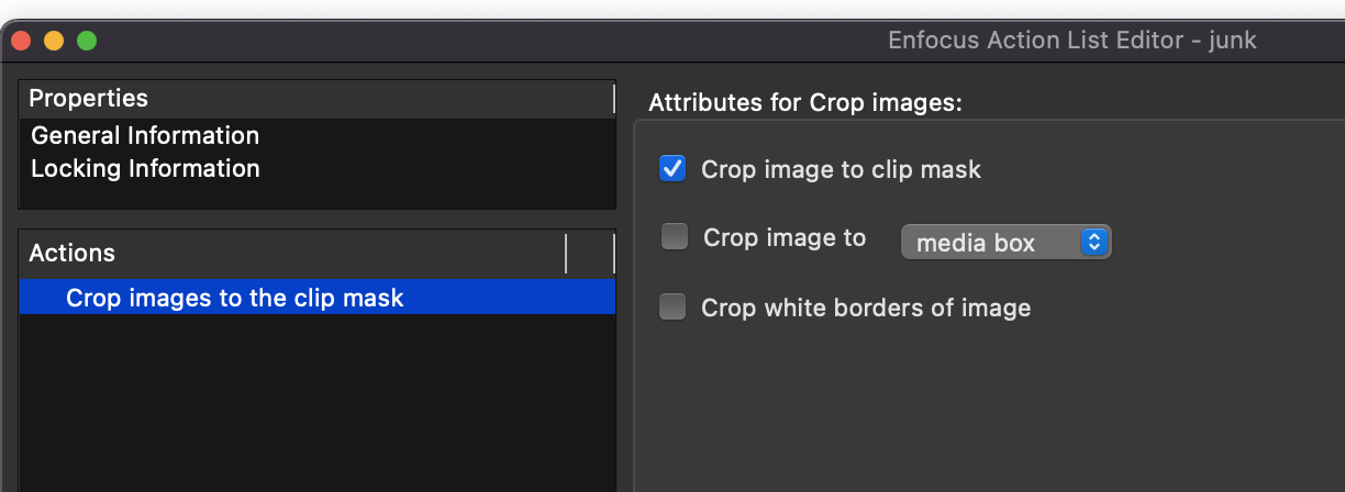

When I run the "Crop Image to the Clip Mask" it doesn't crop the image to the clipping box but leaves a little "overhang" of the image that's being clipped off.
I use these settings:
crop image to clip mask.png (65.13 KiB) Viewed 10956 times

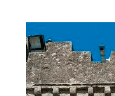

Here's what it looks like if I flip to the wireframe view:

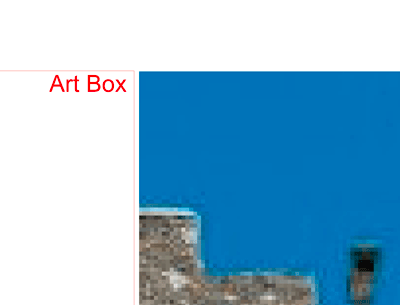

Where I run into a problem is that I then take this Image + Mask and use the "Move Objects to Corner" action to pin to an Art Box. The objects pin to the "Extra Image" that I clipped off, instead of pinning to the Mask. So I get a gap, the distance is the extra clipped image.
Here's what it looks like:
Is there a way to clip the image to the exact dimensions of the Clipping Mask? Or do I have to compensate for it when I use the "Move Objects to Corner" with some offset value?

A property of images is that all pixels have the same size depending on the resolution. You cannot have half a pixel or 1/27th of a pixel. Therefore, the statement that the cropping isn't exact is beside the point. Of course it isn't exact. The reason for this is that line art can be placed at a much higher precision, so a clip mask can cut a pixel in half visually but that does not change the size of the pixel in the image.
The correct problem statement is: PitStop aligns an image with a clip mask to the image instead of to the clip mask when using the Action "Move objects to corner".
I will log that as a bug, but there is an easy different approach that does it correctly: use the Action "Align or distribute objects". You will have to use the Action 2 times, one to align in the vertical direction and one in the horizontal direction. "Move page content to corner" also uses the clip mask by the way.

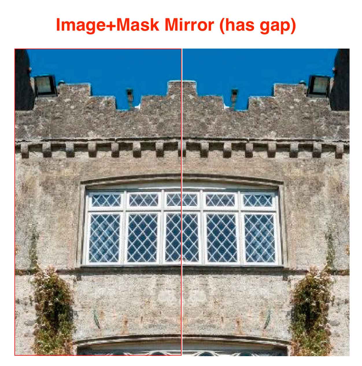

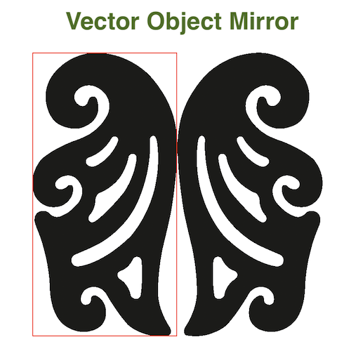

Here's my eal:
Here's the output with two types of simple objects:
Vector Mirror.png (116.68 KiB) Viewed 10876 times

Interestingly, we recently had a similar issue. I think you're on the right path. Try this:
Rotate objects as group, relative to the centre right of the visible area of the selection, 180 degrees.
Flip selection vertically, relative to the centre of the visible area of the selection.
