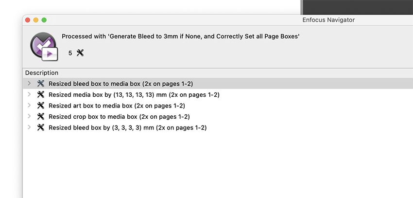

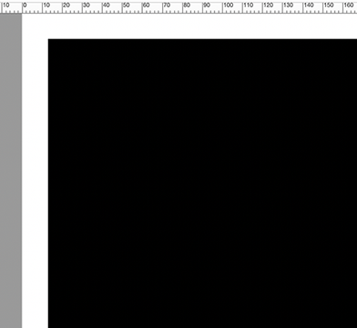

thank you, I have tried that and the coloured box on page 2 stays as A4 size, it doesn't increase into the bleed - please see attached
Screenshot 1.png (61.4 KiB) Viewed 29036 times
Screenshot 1 - original A4 PDF (from word)
Screenshot 2.png (85.22 KiB) Viewed 29036 times
Screenshot 2 - successful action
Screenshot 3.png (98.74 KiB) Viewed 29036 times
Screenshot 3 - page 2 image remains as 210mm x 297
Any ideas?
loicaigon
Posts: 782
Re: Simple add bleed on document with no bleed
Post by loicaigon »
Select the object and look at the inspector the exact coordinates and dimensions, shall the object be a slight portion further, then it would be discarded.
Otherwise, you can either contact support if the file is not sharable or post your PDF here.

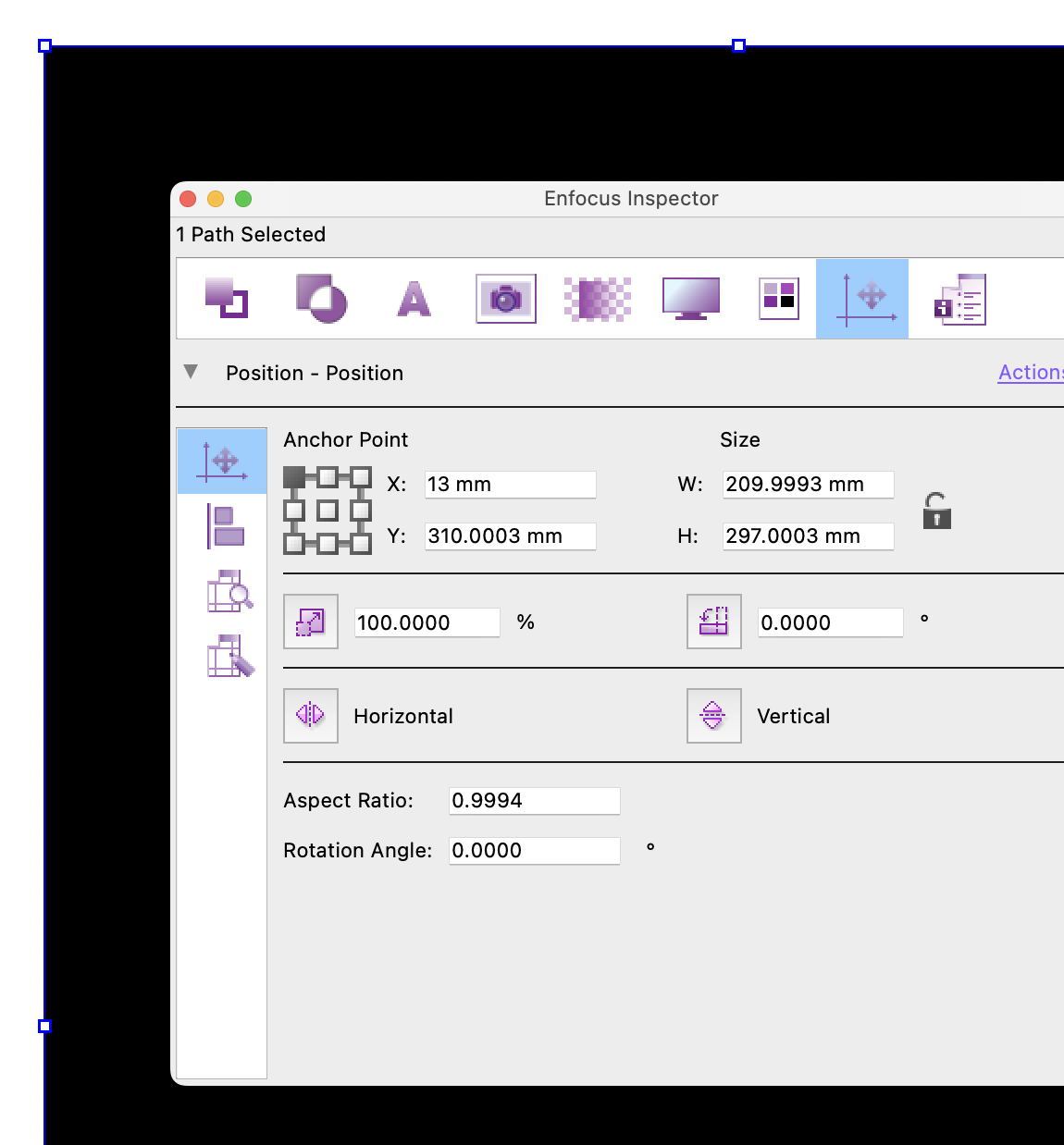

Screenshot 2024-08-30 at 08.10.53.png (240.76 KiB) Viewed 29034 times
the black box remains as it was originally set, (A4)
loicaigon
Posts: 782
Post by loicaigon »
Applying your properties, it works fine to me. Might be something with the file, is the TrimBox defined?
