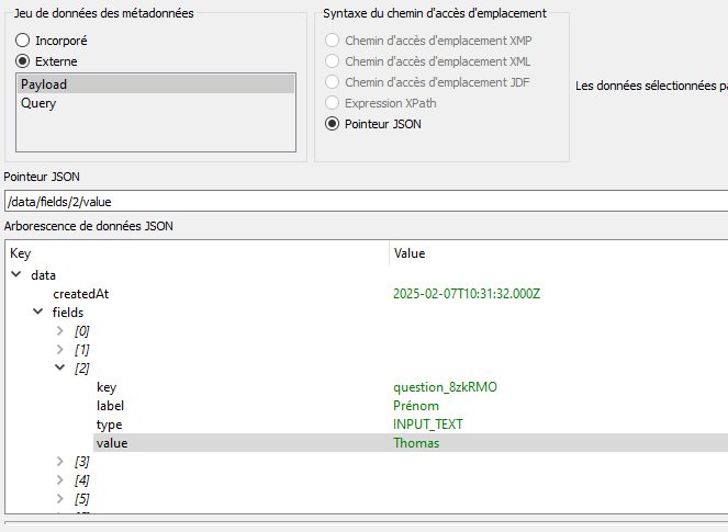

Hello,
is there a trick to retrieve the value following the key given in a structure like the one below?
Instead of using this way?
[Metadata.Text:Dataset="Payload",Model="JSON",Path="/data/fields/2/value"]
Thank you.

I try this but without success.
Have I made a mistake?
[Metadata.Text:Dataset="Payload",Model="JSON",Path="/data/fields[key='question_8zkRMO']/value"]
or
[Metadata.Integer:Dataset="Payload",Model="JSON",Path="/data/fields[key='question_8zkRMO']/value"]

Sorry. I missed yours data was JSON.
I think my method only works with XML.
Posts: 1183
Re: Location Path Metadata List
Correct, Jimmy, your method will only work with XML but it is easy to convert a JSON to XML with "JSON pickup - Pickup result - XML".
