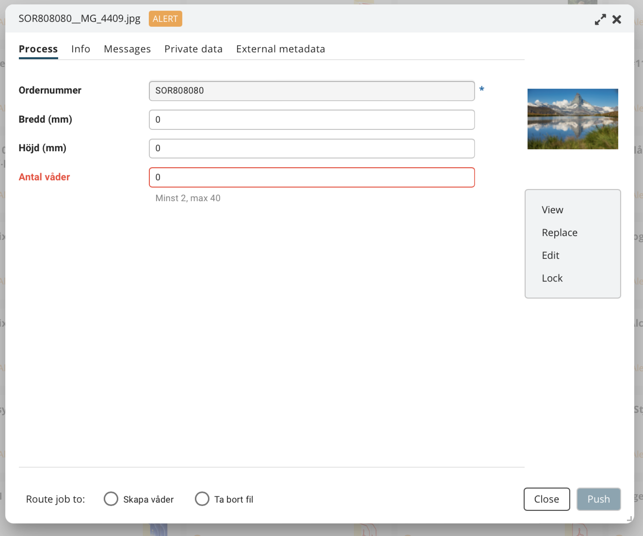

I have a flow for wallpaper-creating where I like to present the initial dimensions in a checkpoint before the next step, like this:
Skärmavbild 2025-03-17 kl. 15.06.44.png (174.51 KiB) Viewed 89066 times
